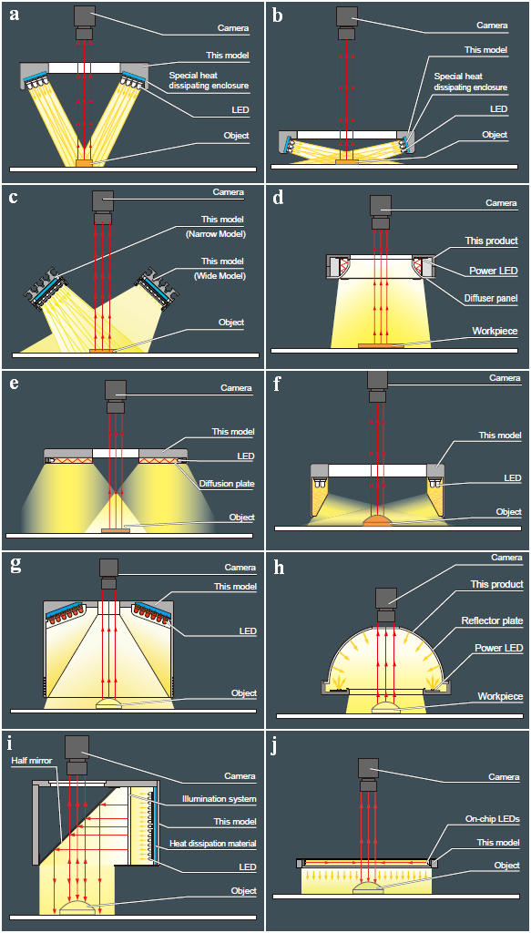

And what the brightness would be enough to overcome the typical brightness of sunlight?
Which a lighting model is preferable in this case?

I see. The camera and light are not perpendicular to the surface of the dial, which is why the reflection is at the top.  Positioning the camera and light perpendicular would not help you anyway, because the light is smaller than the dial.  You would get a reflection of the ring light that would make analysis impossible.
If possible, I would move just the camera to perpendicular.  This will give you the most accurate readings.  If it can't be moved, it will work pretty well where it is.
If you moved the light up a little bit, just above the camera, it would eliminate the reflection.  The lighting would probably be even enough for analysis.
I can come up with a couple of good lighting options.  The first would be two spotlights, positioned 45 degrees to the left and right of the camera.  The second would be a long bar light (about twice the width of the dial) placed horizontally above the camera. The goal is to position the light where it does not reflect into the camera.  Above or to the sides is your best option.  You also want the light coming from as many different directions as possible to eliminate shadows.
In answer to your question, options a,c, and e are all pretty good.  Notice the lights are far outside the object of interest, so the light hits at about 45 degrees.
