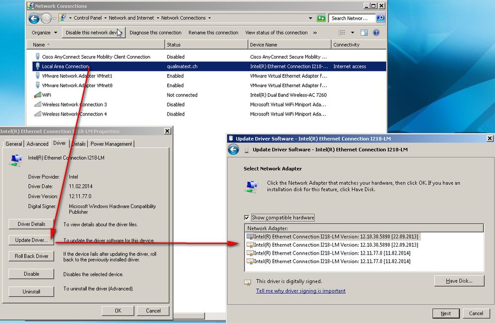

you also can chech that both ports are configured to use NI GigE Vision driver, this is in Windows network settings, you have to select the driver manually :
see also : https://knowledge.ni.com/KnowledgeArticleDetails?id=kA03q000000YM6JCAW&l=en-US#toc3
