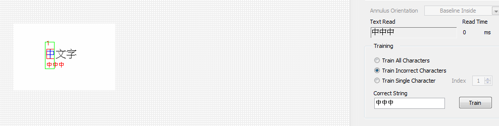

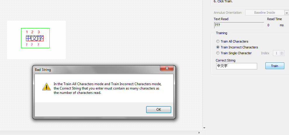

Dear all,
I'd like to recognize the chinese characters via OCR toolkit,
As for the english and number characters, I could train several chacters at once, say "abc123".
When I, however, train several chinese characters, it will come out incorrect character number warning popup.
In additional, it can name a character to be multiple chinese characters.
Does it mean that I must train chinese character one by one, never all characters?
The chinese characters is are not "effective" characters for LabVIEW OCR toolkit to process individully, and it can only treat them as a whole to process.
Could someone give me some suggestions? Thanks a lot.

Hi, Bruce,
Thanks to your reply.
Yes, Chinese character is 2 bytes, and English character is 1 byte.
But the OCR toolkit does not consider the actual length of the character, but treat not alphanumeric characters as a single character.
That is what I think I can recognize an object as several chinese characters.
You can see the second image of the top post that LabVIEW get one character of interest, and I can train it by three chinese characters.(Of course not for the English character case)
I'll train one character at a time in the future, thanks again to your suggestion!

I have to correct my question that it can train several Chinese characters at a time when I update my Vision version to 2013.
The question I met is under Vision 2011 version.
Sorry if others are confused.
