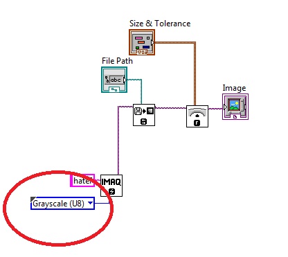

Thank for answer, for sure i will works. But now I have another solution of this. I will use IMAQ low pass filter beacuse I read it's works sht like blurring. But i have problem with error invalid image type.

first using low pass filter is algorithmic method for increasing detail visuality to see in picture and it is not exactly what focusing of optic do , is  make more details not
also error is for RGB
see this
