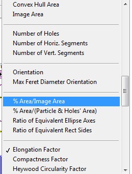

also what you done in your  vi for escape form making classify files  is good and now you can classify your abject with that
for example you can use % area / image and use compression to classify object to 3 class   under10%  under 30%  under 60%  and call them
small medium and big abject (just use case structure ans compression ) any time you want you can change classify by change present controls and rename them also you can all class or remove just by some easy codes
