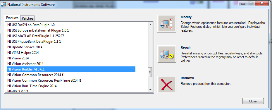

Also, note that the NI installers are labeled in the system install/uninstall dialog as the single item "National Instruments Software". If you select to Uninstall/Change this item, it will let you select the specific item on a second dialog.

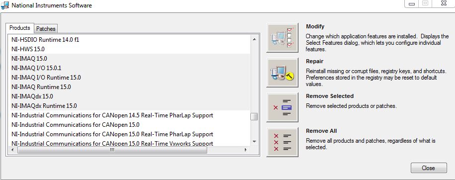

The VAS won’t show up as a whole package when uninstalling. Remember that it is actually installing IMAQ, IMAQdx and IMAQ IO which are separated components that you can uninstall one by one.
In any case, I would go with running again the VAS installer as BlueCheese mentioned to add the corresponding LabVIEW support.
