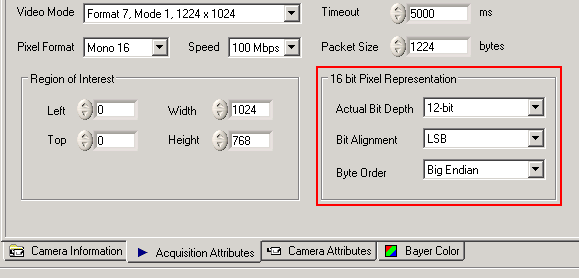

In NI-IMAQdx we attempt to query the camera for its actual bit depth. I do not know about the Orca AG, but some cameras incorrectly report their actual bit depth. Be sure to check your 16-bit Pixel Representation settings in MAX. You can override the "Use hardware default" and set the exact settings of your camera. For the Hamamatsu I believe you want to use 12-bit, LSB, and big-endian. See attached screenshot for 16-bit settings.
Hope this helps.
JohannS
