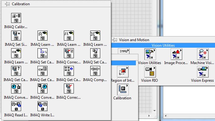

I have another doubt, related to calibration. I am trying to find IMAQ learn calibration template VI but I couldn't find in the functions palette I have. I am using LabView 2014, could you let me know if there is a way that I can download specific VI and attach them to function palette. Thanks.
