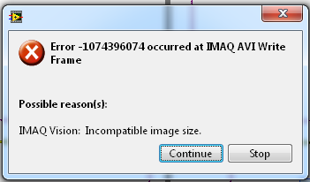

I have this kind of error

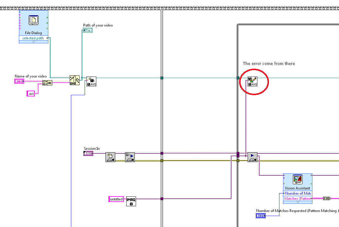

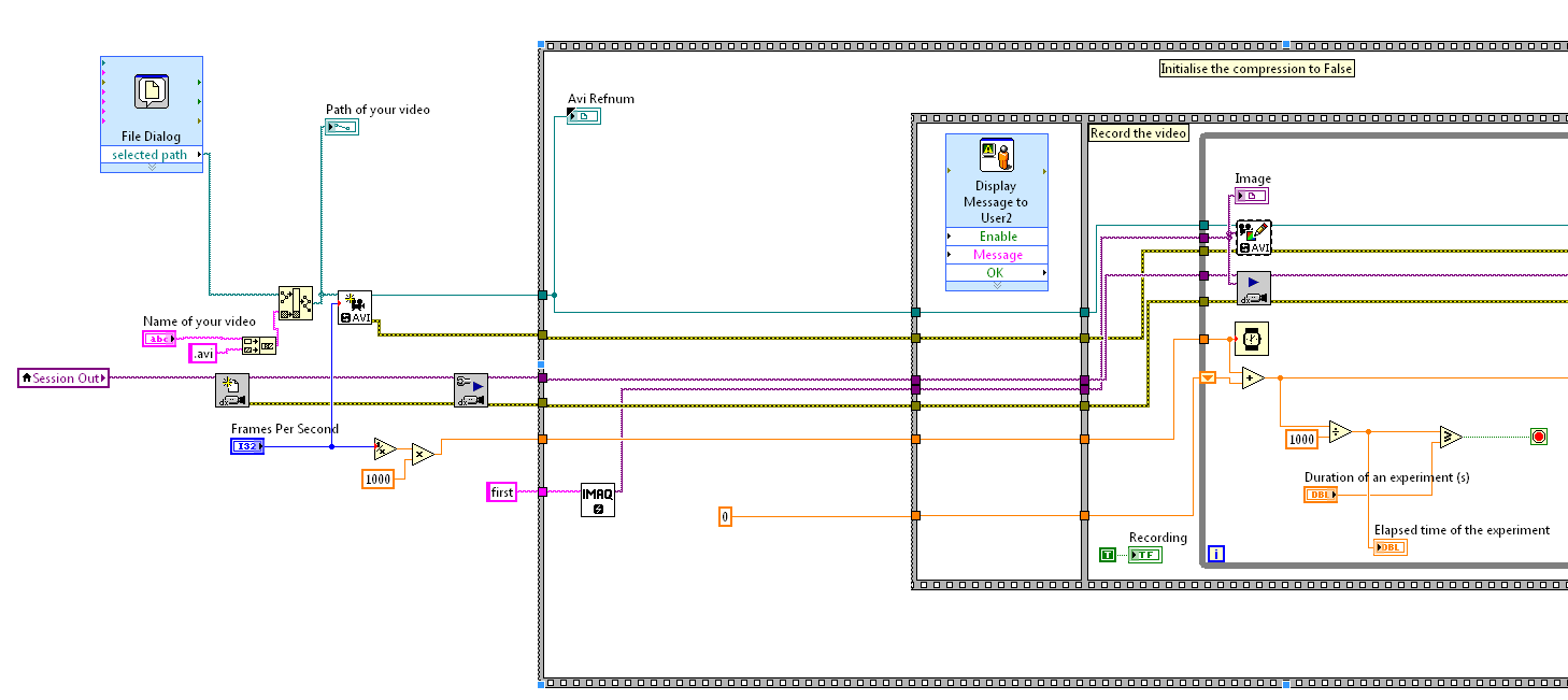

But I don`t understand because I have two software, the first works very well, So I just copy this code to put in the second software, just to record one video.
Everything it`s the same but with the second there is this error message.
this software works very, whitout problem.
And this software, you cansee it is the same code, doesn`t work
I can`t understand why really..... I try to change the format of the imaq, or use IMAQ cast imag, but whitout results.....

First thing that strikes me as strange is that you are pulling the image reference from the inup of grab, and not the putput.  This makes sucess dependent on a race condition where the image is acquired before the write VI gets the image reference.

Some image codecs also have restrictions on image size (usually alignment of the width).

I wrote exactly the same code in the software which work and everything work..... So just strange but anyway, it`s work....

It is strange that if you used the same code, one time it works and another time it doesnt. To be able to see good if there is an error it would be great if you could submit your VI. But first try to take a look at this KB: http://digital.ni.com/public.nsf/allkb/4FAC615B62919BA5C1256ED00046997A
This explains the error and I hope you will understand which steps to take as there are also other links inside this KB for more information. So please verify the KB mentioned above and the settings you are doing in your code.
