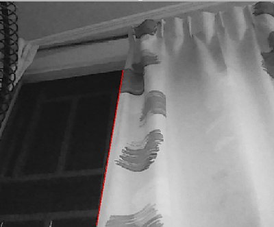

you can try using the Hough line transformation. Assuming you are trying to detect the curtain edge:
Basic Hough line transform:
Probabilistic Hough line transform:
The processing for both takes ~6 ms (I have a (low)mid range computer).
You can find the code and examples here:
https://decibel.ni.com/content/blogs/kl3m3n/2014/09/05/point-cloud-library-pcl-and-open-computer-vis...
You can also do it in Labview - I think it's called "IMAQ Find Straight edges -> Hough Edge Rake". It is also based on Hough line transform.
You are probably detecting the edges, but not displaying them correctly? Or you just need to setup the parameters based on your setup. I have Labview 2013, so I cannot check your code.
