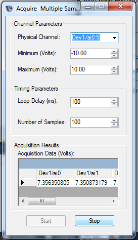

Hello Hame,
If you use the example included with the DAQmx driver, you can specify multichannel acquisition from the user interface. Multiple channels can be designated in the physical channels field in the user interface. Multiple channels such as channels 0 to 5 can be designated as Device Name/ai0:5.
