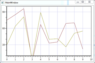

I have a graph whose Y axis shows the axis in multiples of 30, 60, or 90, etc. [project attached]
I use a dynamic interval mode by a converter.
When the edge values are in multiples the graph is displayed well, but when they are not multiples they are not displayed.
For example, when the minimum is 10 and the maximum is 100, it is presented as follows:
I would like the edge values to be displayed anyway, and the values in the middle will relate to the rule.
In the example I would expect to be displayed 10 then 30 - 60 - 90 - 100.
How can I do this?
