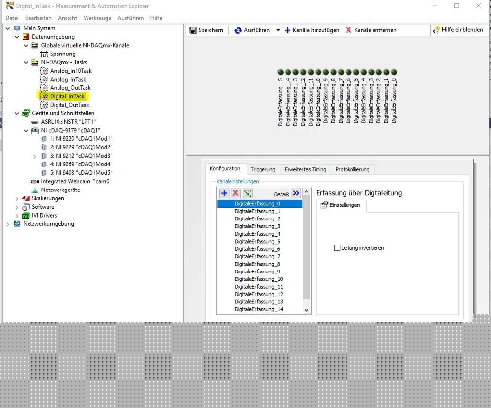

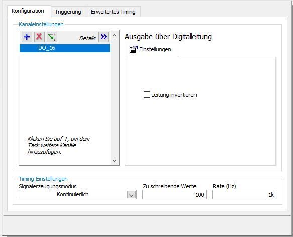

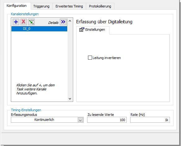

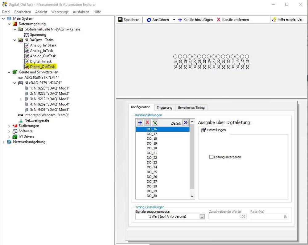

First 0 - 15 lines are defined as input and 16 - 31 for output in separate tasks.DigiIn.JPGDigiOut.JPG
The simple task is, to read input channels continuesly in a thread and sporadically write values into output channels.
If I use tasks created in MAX, everything works fine, but only if they both are set to "1 Value (On Demand)". But as I tryed to create task in C# I recognized that required SampleQuantityMode = "1 Value (On Demand)" is not available! If I choose anything else for DigitalOut_Task, the software throws an error.

You can try it in MAX also:
1. Create Digital In Task for Line0 and set it to values available in SampleQuantityMode like ContinuousSamples or FiniteSamples
2. Create Digital Out Task for Line16 and set it to values available in SampleQuantityMode like ContinuousSamples or FiniteSamples

I found out, If I use Input Task created in MAX with "1 Value...", then I am able to create my Digital In Task in C# without problems.
