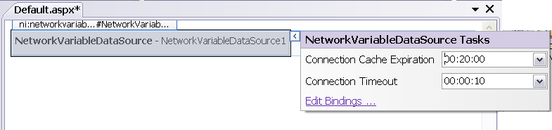

You will need to Add a Network Variable Data Source to the Designer, select Edit Bindings and bind to the network variable you want to be displayed on your Measurement Studio Waveform Graph.

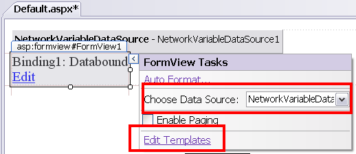

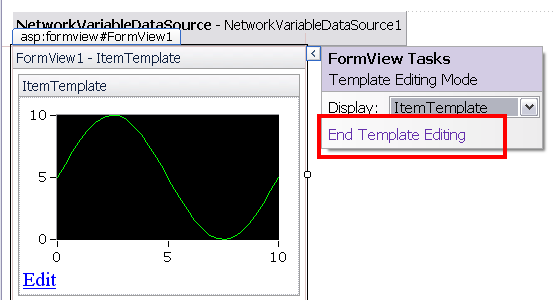

Then you can add a FormView control to the Designer and set the Data Source to the Network Variable Data Source control that you just added. You can then select Edit Templates in the FormFiew smart tag and add controls that you want to be visible on the web site.

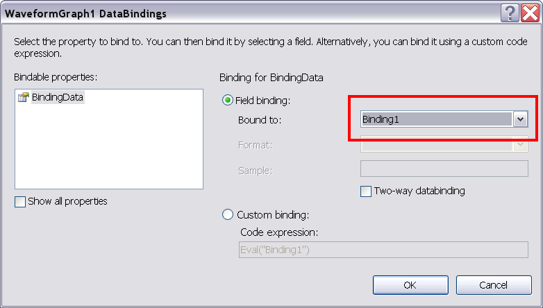

You can delete the populated binding that appears by default. Drag the Measurement Studio Waveform graph into this FormView control and select Edit DataBindings on the Waveform Control.
Here you can specify the binding to the variable that you configured in the Network Variable Data Source.
You can now select End Template Editing for the FormView Control.

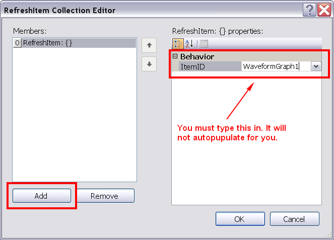

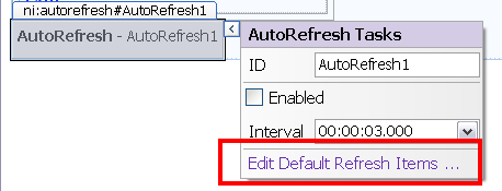

To AutoRefresh the Controls in the Form View, add a Measurement Studio AutoRefresh control to the Designer and select Edit Default Refresh Items.
Select Add and TYPE the name of the Waveform Graph control that was added to the FormView control.

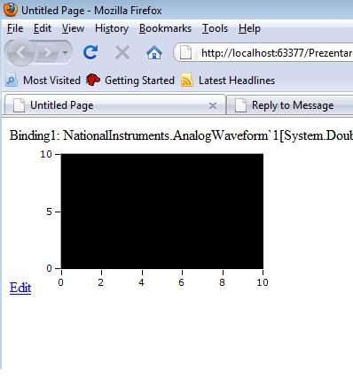

Thanks for the idea, I've tried that before and no result.

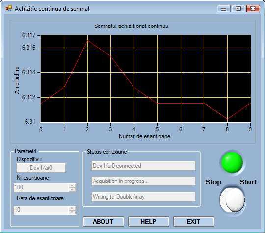

My WindowsForms application for the acquisition code looks like:
#region vars
            private string _networkVariablePath;
            public NetworkVariableWriter<AnalogWaveform<double>[]> myNetworkVariableWriter;
        #endregion
        public void Initialization()
            _networkVariablePath = @"\\localhost\system\myVariable";
            myNetworkVariableWriter = new NetworkVariableWriter<AnalogWaveform<double>[]>(_networkVariablePath);
            myNetworkVariableWriter.Connect();
 private void daqTaskComponent1_DataReady(object sender, DaqTaskComponentDataReadyEventArgs e)
            NationalInstruments.AnalogWaveform<double>[] acquiredData = e.GetData();
            myNetworkVariableWriter.WriteValue(acquiredData);
            waveformGraph1.PlotWaveforms(acquiredData);
I have a continuous data acquisition there and that part is working properly.

Well, I know that project. I have Visual Studio 2008, Measurement Studio 8.6 Enterprise, DAQmx driver for NI USB 6009, and NI USB 6009 acquisition card. I know the code from Measurement Studio User Manual. The problem comes when I'm trying to plot data acquired real time from the NI USB 6009. When I use software generated signals everything works fine.

I just tested the code Adri posted, and all I had to do was publish the live data to a network variable, then bind the Waveform Graph to that variable.  All I had to do was to open the code by going to File»Open»Web Site, then select the ReadingNetworkVariable folder.  This opened the ReadingNetworkVariable project.  I then selected the "NetworkVariableDataSource" item at the top of the Default.aspx designer page, clicked on the arrow to the right of it and selected "Edit Bindings".  From there I could modify the Location property of Bindin1 to be my variable.  After that, I just ran the webpage and it worked.  What problems are you seeing?

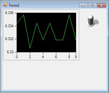

I found a solution
 private void Acquisition()
if (_runningTask == null)
try
_myTask = new Task();
_myTask.AIChannels.CreateVoltageChannel(textBox1.Text,"", AITerminalConfiguration.Differential, Convert.ToDouble("-10"),
Convert.ToDouble("10"), AIVoltageUnits.Volts);
_myTask.Timing.ConfigureSampleClock("",numericEdit2.Value, SampleClockActiveEdge.Rising,
SampleQuantityMode.ContinuousSamples, Convert.ToInt32(numericEdit1.Value));
_myTask.Control(TaskAction.Verify);
_runningTask = _myTask;
_myTask.Stream.ReadOverwriteMode =
ReadOverwriteMode.OverwriteUnreadSamples;
myAnalogSingleChannelReader = new
AnalogSingleChannelReader(_myTask.Stream);
analogCallback = new
AsyncCallback(MyAnalogSingleChannelReaderCallback);
myAnalogSingleChannelReader.BeginReadMultiSample(Convert.ToInt32(numericEdit2
.Value), analogCallback, _myTask);
catch (DaqException exception)
MessageBox.Show(exception.Message);
_myTask.Dispose();
this.switch1.Value = false;
private void MyAnalogSingleChannelReaderCallback(IAsyncResult
asyncresult)
try
if (_runningTask == asyncresult.AsyncState)
_myData =
myAnalogSingleChannelReader.EndReadMultiSample(asyncresult);
long newSamples =
_myTask.Stream.TotalSamplesAcquiredPerChannel -
_myTask.Stream.CurrentReadPosition;
if (newSamples <
_myTask.Stream.AvailableSamplesPerChannel)
_myTask.Stream.ReadRelativeTo =
ReadRelativeTo.CurrentReadPosition;
_myTask.Stream.ReadOffset = 0;
else
ReadRelativeTo.MostRecentSample;
_myTask.Stream.ReadOffset = -
(int)_myTask.Stream.AvailableSamplesPerChannel;
this.textBox6.Text = "Writing to DoubleArray...";
myBufferedWriter.WriteValue(_myData);
waveformGraph1.PlotY(_myData);
_runningTask = null;
_myTask.Dispose();
Message Edited by KarinaA on 07-22-2009 07:34 AM
