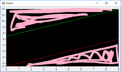

I've a scatter graph with a plot and two templates plots.
I would like to get a color outside those plots like the pink color on the picture.
How to do the trick ?

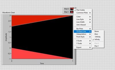

Hi Flow,
I am assuming you would like this in LabVIEW if so, see below:
You could use the Fill Base Line option by right-clicking the Plot legend and select the option 'infinity'.

Hi Flow,

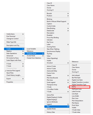

You can also do this programmatically by adding a property node by right clicking the graph and following this:

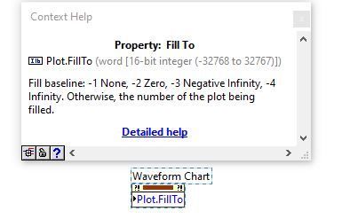

You will need to add a constant value to the property node, see the context help for more info:
I have added an example for LabVIEW 2018, let me know if you need it for another version.

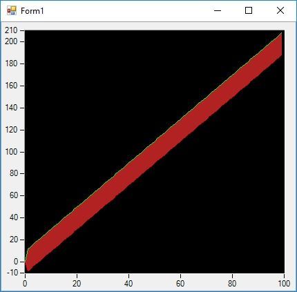

ahhhh just find out my solution.
Thank you very much for your help.
For information, the solution :
this.scatterGraph1 = new NationalInstruments.UI.WindowsForms.ScatterGraph();
this.xAxis1 = new NationalInstruments.UI.XAxis();
this.yAxis1 = new NationalInstruments.UI.YAxis();
this.scatterPlot1 = new NationalInstruments.UI.ScatterPlot();
this.scatterPlot2 = new NationalInstruments.UI.ScatterPlot();
((System.ComponentModel.ISupportInitialize)(this.scatterGraph1)).BeginInit();
this.SuspendLayout();
// scatterGraph1
this.scatterGraph1.Dock = System.Windows.Forms.DockStyle.Fill;
this.scatterGraph1.Location = new System.Drawing.Point(0, 0);
this.scatterGraph1.Name = "scatterGraph1";
this.scatterGraph1.Plots.AddRange(new NationalInstruments.UI.ScatterPlot[] {
this.scatterPlot1,
this.scatterPlot2});
this.scatterGraph1.Size = new System.Drawing.Size(428, 391);
this.scatterGraph1.TabIndex = 0;
this.scatterGraph1.UseColorGenerator = true;
this.scatterGraph1.XAxes.AddRange(new NationalInstruments.UI.XAxis[] {
this.xAxis1});
this.scatterGraph1.YAxes.AddRange(new NationalInstruments.UI.YAxis[] {
this.yAxis1});
// scatterPlot1
this.scatterPlot1.BasePlot = this.scatterPlot2;
this.scatterPlot1.FillBase = NationalInstruments.UI.XYPlotFillBase.Plot;
this.scatterPlot1.FillMode = NationalInstruments.UI.PlotFillMode.Fill;
this.scatterPlot1.XAxis = this.xAxis1;
this.scatterPlot1.YAxis = this.yAxis1;
// scatterPlot2
this.scatterPlot2.BasePlot = this.scatterPlot1;
this.scatterPlot2.FillBase = NationalInstruments.UI.XYPlotFillBase.Plot;
this.scatterPlot2.XAxis = this.xAxis1;
this.scatterPlot2.YAxis = this.yAxis1;
