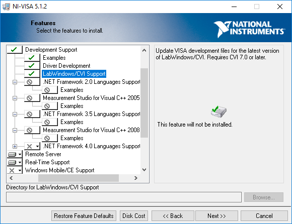

Screenshot attached. ".NET Framework 3.5 Language Support" - "This feature will not be installed."

I finally figured out a way around the NI installer. I thought it would be good to document it here in case anyone ran into the same issue.
Initially I attempted to install .NET framework 3.5 support on my Windows 10 machine, but even though the framework was properly installed, the NI installer refused to detect it.

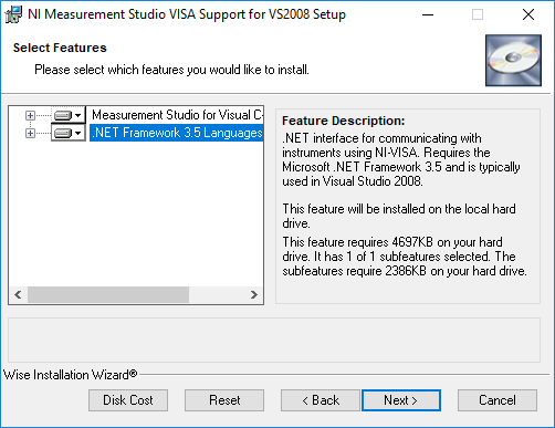

The workaround I discovered is to install NI VISA without support for any .NET frameworks and manually force the installation of .NET support. Once the install completes, open the folder where VISA was extracted and navigate to: NI-VISA > 5.1.2 > Products > NI-VISA
Once there, open the MStudioVisa.2008.msi installer and enable the installation of support for .NET languages. If everything installed correctly, the libraries should be located in the correct location for VS 2008 to find!

The workaround I discovered is to install NI VISA without support for any .NET frameworks and manually force the installation of .NET support. Once the primary install completes, open the folder where VISA was extracted and navigate to:

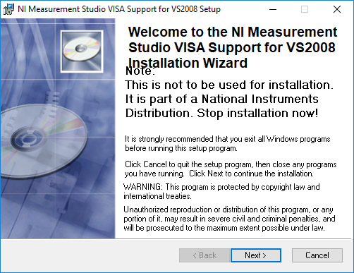

Once there, open the MStudioVisa.2008.msi installer, ignore the warnings about running the installer outside of an NI installer, and enable the installation of support for .NET languages. If everything installed correctly, the libraries should be located in the correct location for VS 2008 to find!
Hope this helps!
