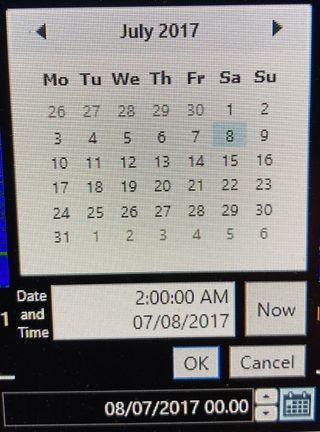

The ValueFormatter solution works good! However, I noticed another issue. The format used inside the calendar is US DateTime, whereas the textbox use regional DateTime settings (see picture). Is this a bug? Is there a solution to this?

The date time popup uses the same general format for all values. There is no direct way to configure this on the control, but you can use a custom control template to change the value in the popup:

The StringFormat in the PART_DateTimeTextBox contains the value to update.

The Style works perfectly! However, I noticed another issue. For some reason the time in the drop down box shows one more hour than in the text field. If you look at the attached image the time in the textfield is 18:10, whereas the dropdown shows 19:10. Do you know why? This seems to be the same if I drop the Style also.

Looking at your original screenshot, I see the issue there was between "00.00" and "2:00" — a two-hour time difference there. This leads me to suspect a time zone issue (e.g. displaying as UTC in some places, and Local elsewhere).
I believe the popup always tries to display the Local time (which was a choice to match the user’s calendar settings, to make picking a specific date easier). Possible things to check:
  • Is the control Value set with a time that has an Unspecified Kind? (This may cause the value to get “re-interpreted” when it is displayed in different areas.)
  • Is the control DisplayKind property set to UTC? (This would “conflict” with the popup calendar design choice to use Local.)
If it is a Local vs. UTC issue, you could use a converter instead of a format string in the binding you customized.
~ Paul H

You are correct this is definitely a UTC problem. If I set windows time zone to UTZ+0 all works fine. If I set the DisplayKind to local they will match, but then the displayed value will be the control value compensated by the time zone. This means if I set the control value to 10:00, both my textbox and dropdown menu will show 11:00 (I am UTC+1). Do you have an example of how to change the format string to a converter in the Style?

When you say "set the control value to 10:00", how exactly are you setting it? E.g. in code with control.Value = new DateTime( 1, 1, 1, 10, 00, 00 )? That would leave the Kind as Unspecified, and the control would have to guess at the appropriate interpretation, which could cause mismatches. Using SpecifyKind may work, if that is the problem.

Have tried two approaches for setting the control value, with equal results. One is that is set it directly in xaml, i.e. Value="10:00". The other is that I create a binding which return a DateTime similar to what you describe. But you are correct, if I use SpecifyKind on the DateTime and set it to local this works! Thanks!
