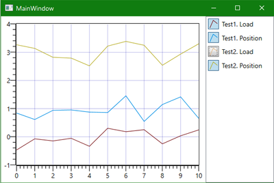

Unfortunately, I could not reproduce the issue based on the code snippets you showed. Here is the XAML I used to define the graph and legend in my test project:
<Grid>
    <Grid.ColumnDefinitions>
        <ColumnDefinition Width="3*" />
        <ColumnDefinition Width="*" />
    </Grid.ColumnDefinitions>
    <ni:Graph x:Name="AnalysisGraph" />
    <ni:Legend Grid.Column="1" ItemsSource="{Binding ElementName=AnalysisGraph, Path=AllPlots}" />
</Grid>
And the code used to populate it with random data:
public MainWindow( ) {
    InitializeComponent( );
    var random = new Random( );
    for( int i = 0; i < 2; i += 1 ) {
        double offset = i * 2;
        double[] load = GetData( random, offset - 0.5 );
        double[] position = GetData( random, offset + 0.5 );
        string name = "Test" + (i + 1);
        AnalysisGraph.Plots.Add( new Plot( name + ". Load" ) );
        AnalysisGraph.Data.Add( new List<object>( ) { load } );
        AnalysisGraph.Plots.Add( new Plot( name + ". Position" ) );
        AnalysisGraph.Data.Add( new List<object>( ) { position } );
Clicking on the legend glyphs shows and hides the corresponding plot like normal (see "Test2. Load"):
You may want to try using WPF Snoop to debug if there is a binding problem with the legend glyph.
