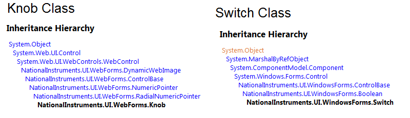

Laseno,
The cursor property is not a valid property in the knob property. Switch inherits the property from the 'controlbase' class while knob does not, unfortunately.
In the help file, it shows the inheritance heirarcy to be :
You may be able to find a workaround using some of the other properties, such as innerbounds or just by using the physical location (and height/width) of the knob.
Kyle Mozdzyn

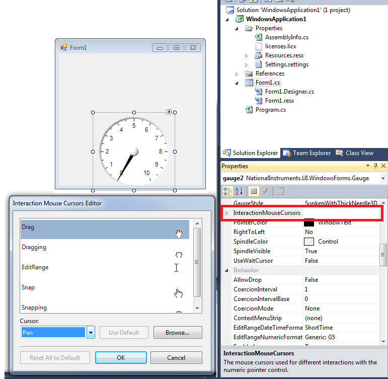

Laseno,
I think I have found a better solution to the issue. Instead of using the knob.cursor property, you can set the default behavior using the InteractionMouseCursors property, which can be seen here for an arbitrary control. I think this will use less overhead and be a more robust solution.
