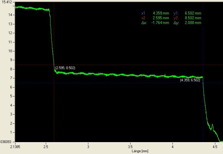

I have a problem with a signal analysis an I hope you can help me.
As you see in the first picture I have a force (y) and a length (x) axis.
The sensor is moving from left to right and is measuring the force with 200000 samples/s.
Moving speed is 10mm/s. So there is a resolution of 20000 samples/mm.
After that the data ist by a Butterworth-Lowpass-Filter, 2nd order with a cut frequency of 10kHz processed.
my problem: how to find the two points (2nd picture, pink circles) to get the length difference between them
my idea : calculate the red straight lines and then calculate the point of intersection between the lines.

Hi
maybe you can take the derivative of your signal.
There is a function for that in Measurement Studio Professional and Enterprise edition 'Derivative x(t)'
Than you can see were the edges are (highest or lowest value)
The function is in NationalInstruments.Analysis.Dsp >> SignalProcessing..::.Differentiate Method
