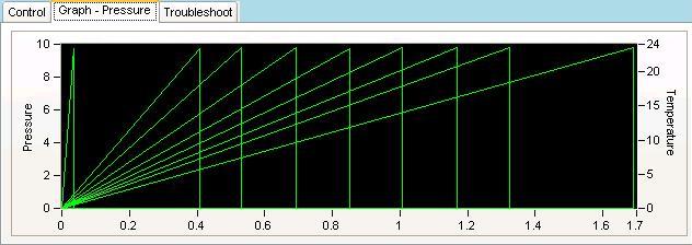

I would like to plot two sets of data points (X1, Y1) & (X2, Y2) on the scatter graph as soon as I receive them, psuedo real time plot.  Below is the data I'm trying to plot.  However the data doesn't look right.  What do I need to do, so my two points are appended to their last points?
do
' read data to get Data1 & Data2
x1 = runLength.TotalMinutes
x2 = runLength.TotalMinutes
y1 = Data1(index)
y2 = Data2(index)
frmInfo.ScatterGraph1.PlotXYAppend(xVal, yVal)
 loop while (flag)
Message 7 of 15
(6,157 Views)
correction in my last code
do
x(0) = runLength.TotalMinutes
x(1) = runLength.TotalMinutes
y(0) = Data1(index)
y(1) = Data2(index)
 frmInfo.ScatterGraph1.PlotXYAppend(x, y)
 loop while (flag)

Could you please be just a little more specific on what you mean by
"so my two points are appended to their last points"
What exactly should be appended to what?  Or what do you expect the plot to look like?
Jensen
Applications Engineer
Message 9 of 15
(6,133 Views)
What I'm looking for is a way to have two streams of data.  One would be plotted on the primary Y axis, and the other would be plotted on the secondary Y axis.  The data would be plotted onto the graph when it's received (so appending it to the graph).  Attached is an example of what I'm looking for. (done in excel)
