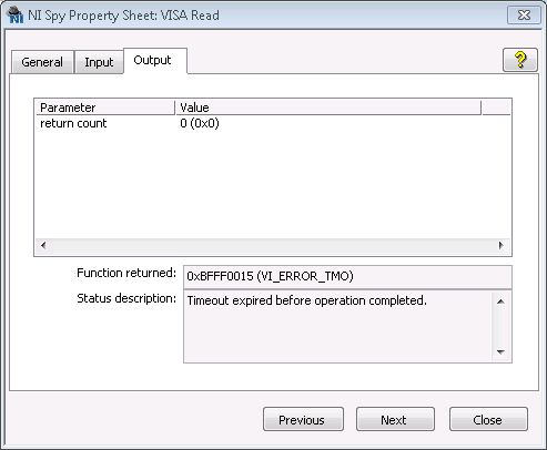

Hi menchar,
If you are using VISA commands, NI-Spy will capture the VISA calls and not the NI-Serial calls.  The information from the VISA calls do have valuable information.  You will be able to see the input and output parameters as well as the buffer contents.
For a VISA read that times out, you would see something like:
