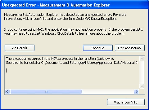

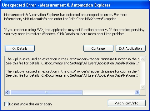

Patrick, after I installed 9.6, when I tried to open MAX, I got an error message not unlike what I've attached below.
Since then, I uninstalled MAX (as well as all programs associated with it - NI Waveform Editor 2.0 Demo, NI Hierachical Waveform Storage 1.41, NI PXI Platform Services 2.6.2 Configuration Support, NI-488.2 3.0.2, NI-DAQmx 8.0, NI-VISA 5.1.1, and NI Visa Server 4.6), and reinstalled DAQ-mx 8.0 and NI-VISA 4.6.
Unfortunately, I still got the same error message.
Attached is the .log file referred to in the error message. I think, at this point, I've messed around with the installation waaaaay too much. Would it be advisable to simply uninstall everything and just start out from scratch again? For what it's worth, I have the CD that came with my NI-6259 (I believe it simply has NI-DAQmx 7.0, but it's a start, at least).

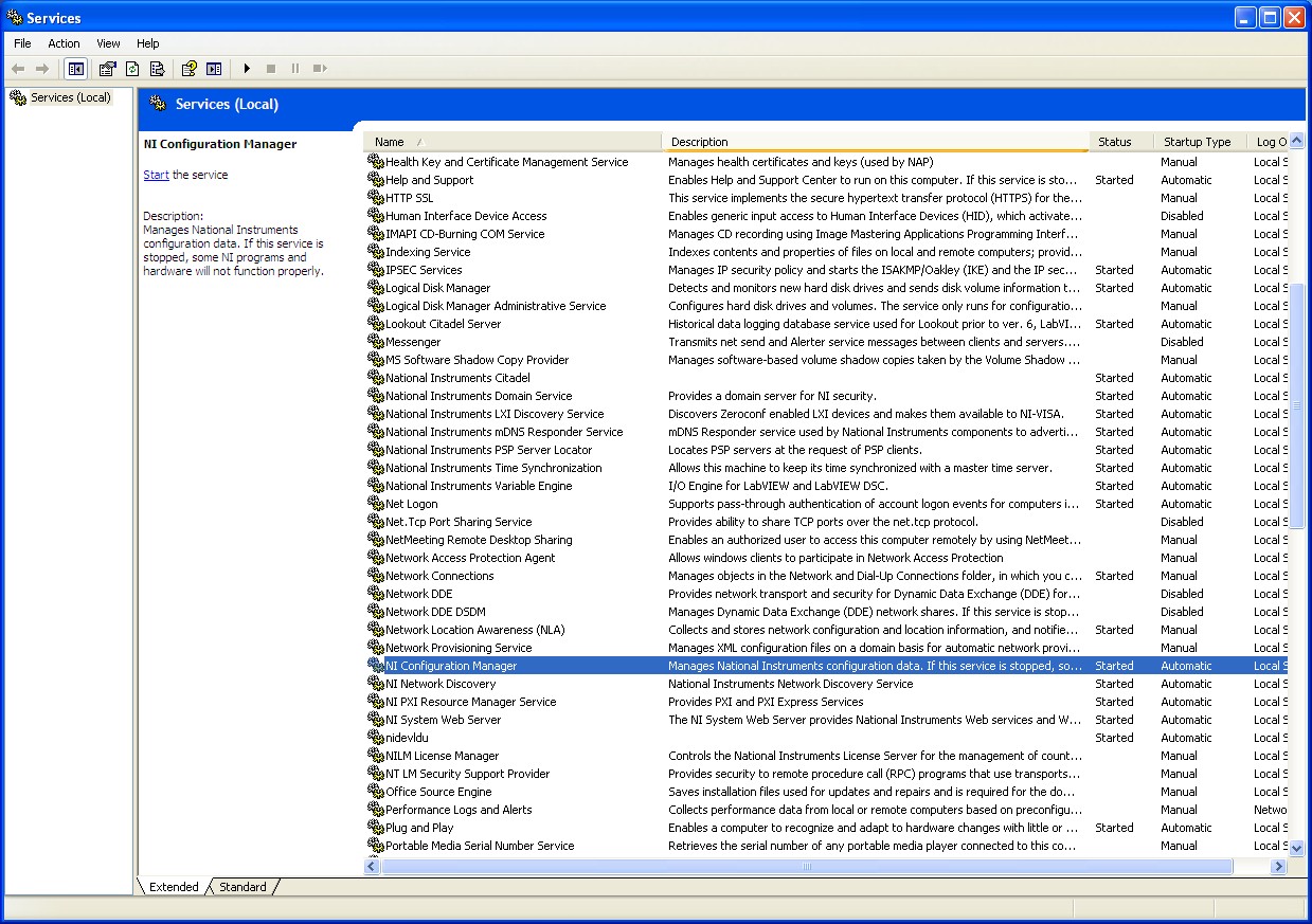

2) National Instruments services not properly starting.  to check this, go to Control Panel » Administrative Tools » Services.  Then, make sure NI Device Loader and NI Configuration Manager are listed and are started.  If they are not, right-click and choose "start".

I turned off the anti-virus SW and firewall (since the computer isn't connected to the Internet, we don't need either anyway), and checked Services. It seems that, while I do have NI Configuration Manager (which I started), I do not have NI Device Loader.

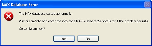

I was able to get Measurement and Automation to run once, but when I tried to load my list of tasks into Data Neighorhood (an entry for which wasn't present), the program crashed. When I tried to restart MAX, I got this error message.

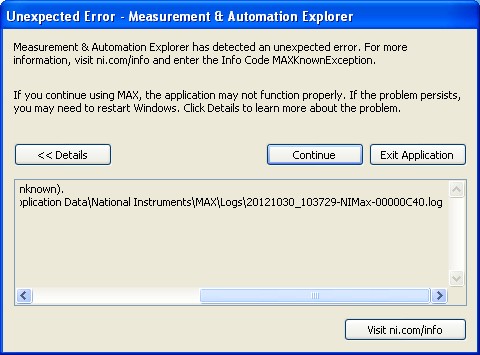

For kicks, I restarted the computer, reactivated NI Configuration Manager, and restarted MAX. I got this message (log and dump files attached).

I got timed out of my last edit. It turns out I do have NI Device Loader (nidevldr) and I did start it at first. I still wound up getting  MaxTerminiatedServiceError after trying to load my tasks.

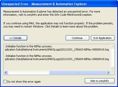

I have, however, since restarted the computer, started the Device Loader and Configuration Manager, and tried opening MAX. The title screen showed up for a couple minutes, saying it was initializing before it all of a sudden exited. I tried restarting MAX, and got this error message (log files attached).
