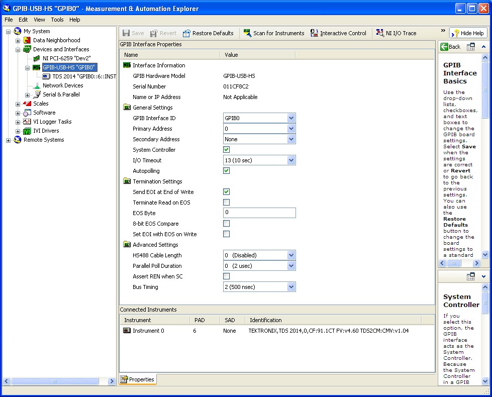

Patrick,
I just finished installing NI-488.2 v3.0.2, the IVI Compliance Package v4.5 (making sure that LabWindow/CVISupport was installed), the tktds1k2k oscilloscope driver v3.2, as well as TekVISA v3.3.4 (making sure that the National Instruments VISA was preserved). When trying to run my program, I get a compile error message: "Method or data member not found" when I try to write something to the oscilloscope. To be sure, I can get data and screenshots from the Tektronix's SW, and I can even communicate with the oscilloscope through the NI-488.2 Communicator feature in MAX.
This is still progress, since everything, except for Excel, is talking to each other now.
Is there anything I might be missing from National Instruments if the Call VISA.TVC.WriteString(... command isn't working?

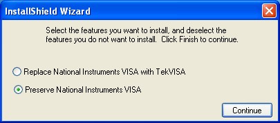

This past Friday, I made a point to ask Tektronix just that question, and they told me that a conflict between both VISAs could definitely be the case, particularly if the oscilloscope is being held by NI-VISA Resource Manager. Does that Manager exist?
I was able to preserve NI-VISA because a window popped up during the TekVISA installation asked me.
Based on what I heard from the person I spoke with at Tektronics, the oscilloscope can only communicate through TVC (part of TekVISA).

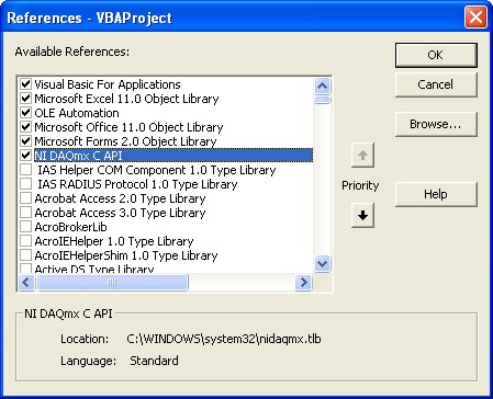

In the meantime, a strange thought came to me: does the NI driver for the TDS2014 create an .olb, .tlb, .dll, or .ocx file that can be used as a reference in VB, and if so, where might I find it? Or would it be in the NIDAQmx C API (nidaqmx.tlb)?
For what it's worth, below are the references I am currently using.

The driver should install a dll file to C:\Program Files\IVI\Bin.  For a bit more information on how to reference the DLL, see this link:
http://www.ni.com/white-paper/4562/en
Patrick W.
Applications Engineer
Message 18 of 20
(5,247 Views)
Just added the reference. While I still get the same error message, I see with the Object Browser that the .dll provides a whole bunch of commands that I may be able to use.

Putting in the references derived from the TDS2014 NI driver worked. With a little web research into what each command does, I've been able to recreate the initialization procedure for our system.
Thank you so much for your patient help. You're a real lifesaver!
