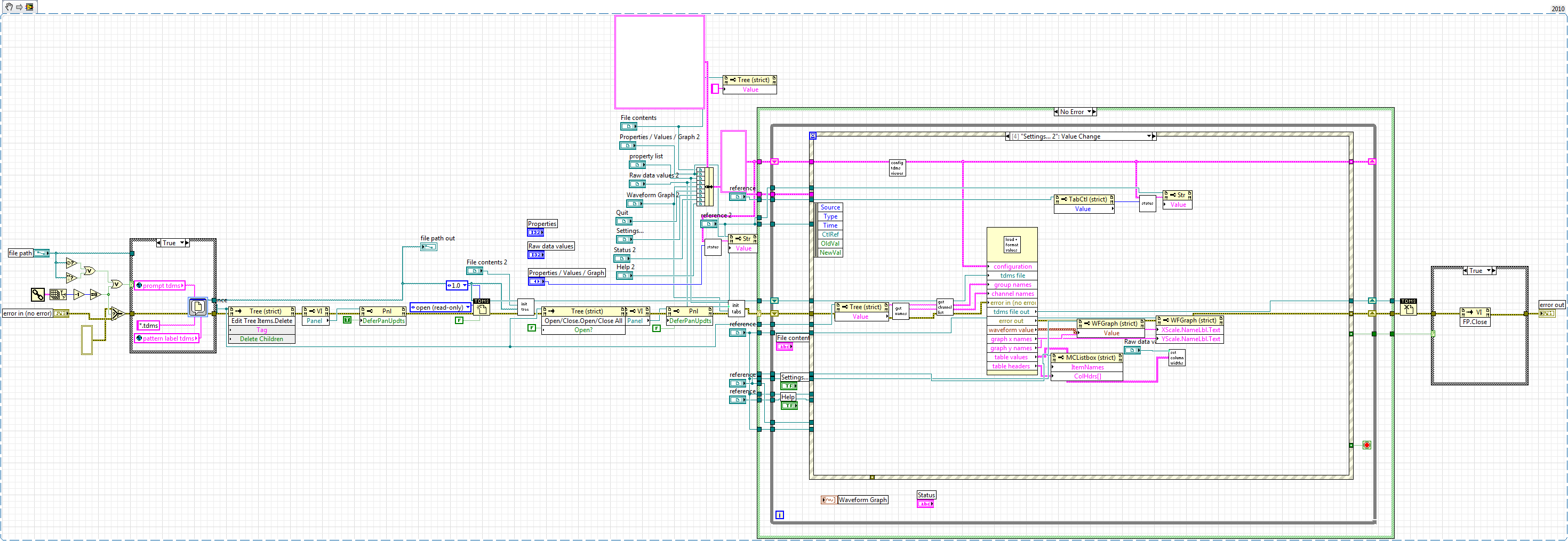

Select TDMS File Viewer.vi and Ctrl+ double-click to open its Block Diagram.  You should see this:  (Adjust for the diferences between a screenshot and the snippet tool)
Yes I chose this vi from vi.lib because it does have critical errors.  Make no mistake- it is functional code!  NI even documents its behavior and functionality! (There are vi's hidden deep in vi.lib that are even more useful, some have bugs)
Now, lets run the VI analizer and see if we could do better.......
Tools>>VI Analiizer- select
analize the current vi- Select Next
Select - Analize-  Refill your coffee- its worth it.........
Now- at home I do not have the entire TK.  How many of you see the "Dead Code" lower left on the event structure (The error tunnel is not wired outside the event case)  subvIs viewed as vis rather than icons?  Those tall yellowish things are vis- (Right-Click them and check the default "View as Icon."  Did you know that is a vi?)
Are those terminals with the same label?
Yup- all easy mistakes to make-  VI Analizer does not make those mistakes.
