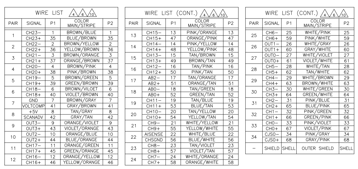

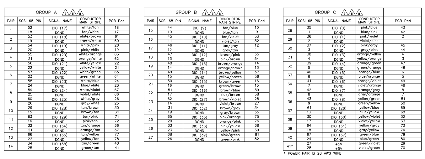

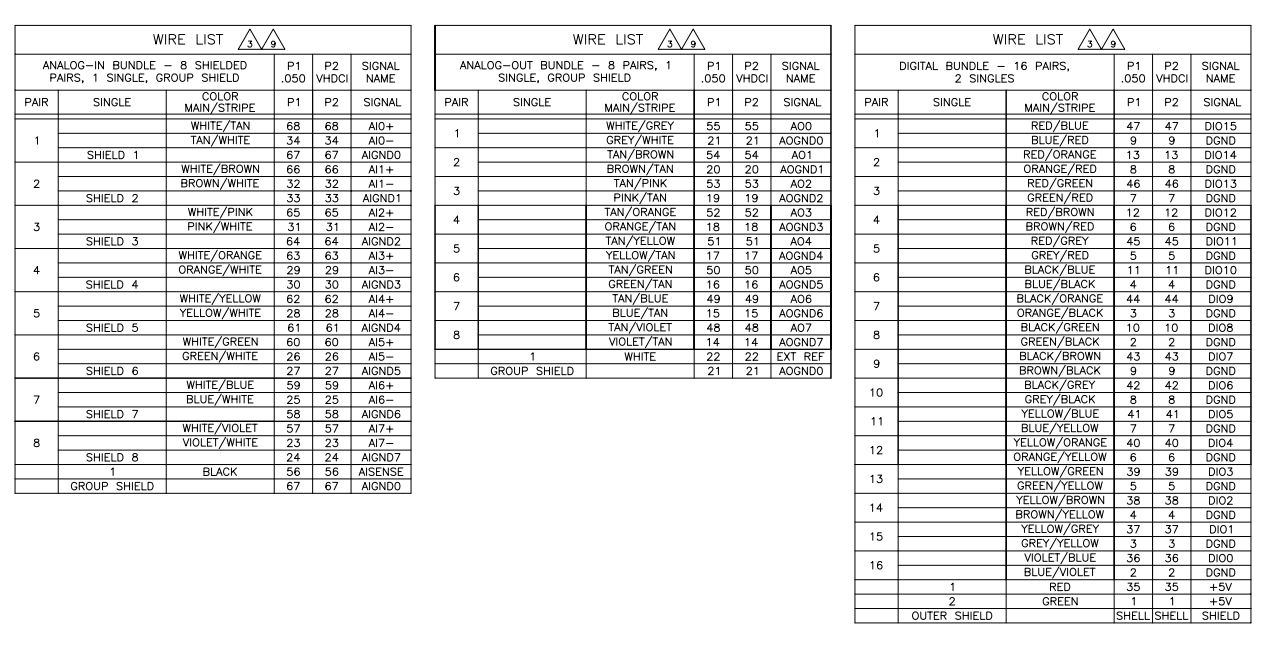

Hello HenningP
SHC68-C68-S 186381-0x
I hope this helps
best regards
Alexander
