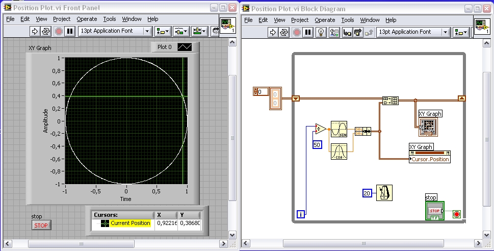

I think the easiest way to do what you want is using a cursor to display the current position. I have attached a little vi (LV 8.2.1) that demonstrates this method.
For the case that you are using an older LV version here is a screenshot.
Please note that this is just a quick example that doesn't limit the amount of memory that is used to display the position data which results in a growing memory consumption of the vi. If you plan to run something like that for a long period of time you should think of ways to limit the memory consumption by limiting the number of position data to be displayed.
