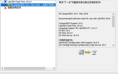

 I can't find NI softmotion in software in remote system software list even i already installed NI softmotion in NI package manager
Sorry for the Chinese character, it's based on my computer default language environment.

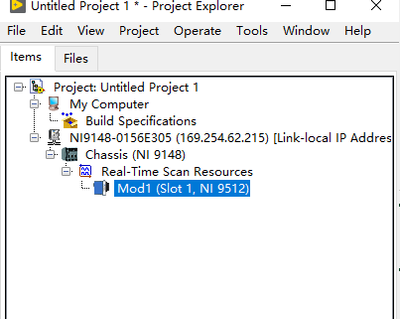

I was stucked in the adding axes to the project in NI 951x C series manual which i attached below.
I followed every steps of manual, but i can not find the axes adding bottom in anycase.
Leopold_316_4-1620017623219.png This is my project.

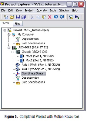

Leopold_316_5-1620017673739.pngThis is project example from manual.
As you can see, I have no dependencies and build specification in my project explorer as well.

Hello Leopold,
You can't find softmoition because NI stopped developing it and version 18 was the last one.
If you want to use Softmotion you have to use it with LabVIEW version 18
