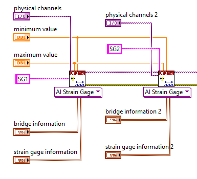

Hi John Nielsen.
You should be able to get data from several channels on the same module, even with different Strain gage information. You can add multiple 'DAQmx Create Virtual Channel' in cascade, which will also force the measurement to execute at the same sample rate.
This will give you a 2D array of doubles. You can look at the individuals datasets by using 'Index Array'.

Thank you for your help.. I'll will try these solutions. 🙂
