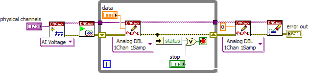

The DAQ version is really perfect - put channel "x" at value "y" and leave it there until I change it. As far as I can tell, no such function exists in DAQmx - I can output waveforms and whatnot, but that's not really helpful.
Of course such a function exists in DAQmx. Not really that much different than traditional DAQ. Have you actually looked at the shipping examples? There's one called Gen Voltqge Update. Below is a slightly modified version.
Message Edited by Dennis Knutson on 04-27-2008 03:21 PM
(4,679 Views)
Dennis,
Thanks - I'm obviously a little unfamiliar with LabVIEW and DAQmx . I just tried the example you mentioned and immediately heard my valves doing exactly what they should be. I may feel foolish given that the example was right there in front of me the whole time, but at least I've got somethign that works well now. Thanks for your patience.
Jed
