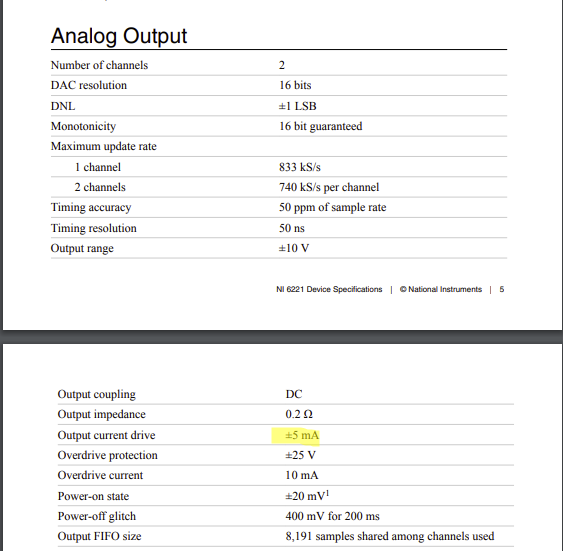

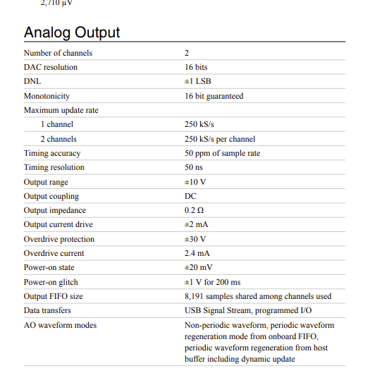

The reason is the difference in the output drive current of each of the cards.
PCI 6221  has a drive strength of 5mA whereas the USB 6216 has a drive strength of just 2mA.
USB-6216 output specification
PCI-6221 output specification

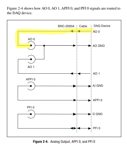

BNC 2090A in noway provides additional drive strength because it is a straight pass-through for AO signals as described in its manual

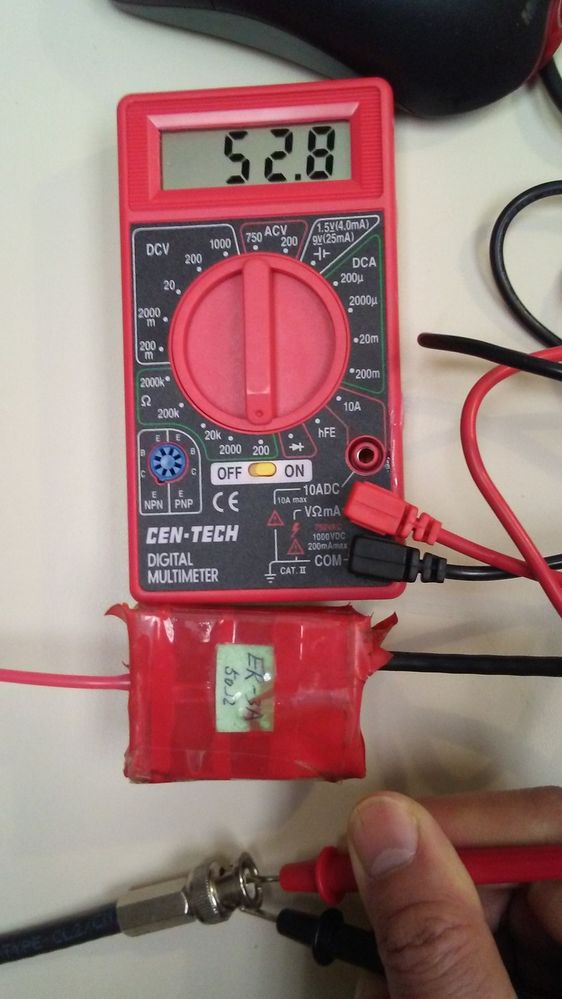

First, I measured the impedance of the ER-3A insert earphone. The DMM reads 52.8 ohms. Please note that, in order to reduce potential electromagnetic interferences, I have used some alloy metal to wrap around the transducer box and taped it with some red tapes. I have also replaced its cable with a shielded BNC cable. This may be the reason that the impedance is slightly higher than 50 ohms.

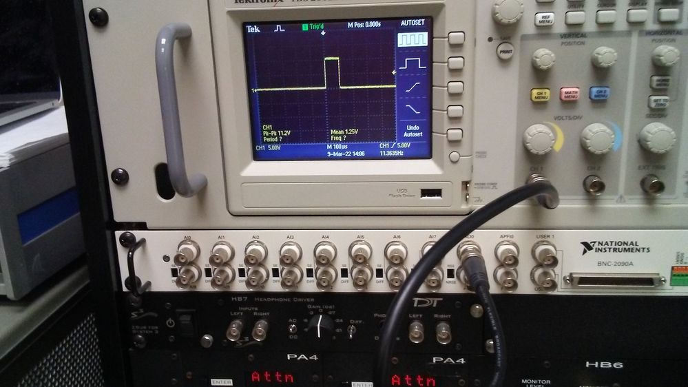

Second, I measured the maximal amplitude of the Ao0 output voltage from PCI 6221. For clarity, I presented a series of electric pulses (pulse width = 100 microseconds), by using a custom program written in LabVIEW (which generates a series of pulses to the Ao0 channel). When the 50-ohm insert earphone is not connected. The oscilloscope reads exactly 10 Vpk and the pulse width is exactly 100 microseconds. So far, everything is good.
Third, I connected the 50-ohm insert earphone, through a BNC T connector, to the Ao0 channel of PCI 6221. The oscilloscope now reads an amplitude of about 7 Vpk. The waveform is bit distorted, but the pulse width is still exactly 100 microseconds. This is where I get confused... The waveform is not clamped to 0.25 Vpk. Why?
