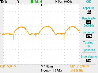

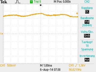

I got a Signal in my NI USB 6009 analog input. Now I have to average this Signal and send it to the analog output. I continuously aquire the signal. The Signal in my input looks like the following Signals:
I think the input signal is a ~ 280 - 300Hz Signal.
Which sample rate I have to take for this 280 - 300 Hz Signal? And how do you averge this signal?
