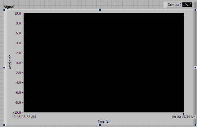

Can you try hooking up a known voltage source that is not varying at all and doesn't have any inherent noise on it?  Something like a 9 volt battery just to make sure the card isn't malfunctioning.
Kyle S
Regional Account Manager
NI
Message 15 of 16
(1,252 Views)
Attached is the measurement of a 9v battery.
