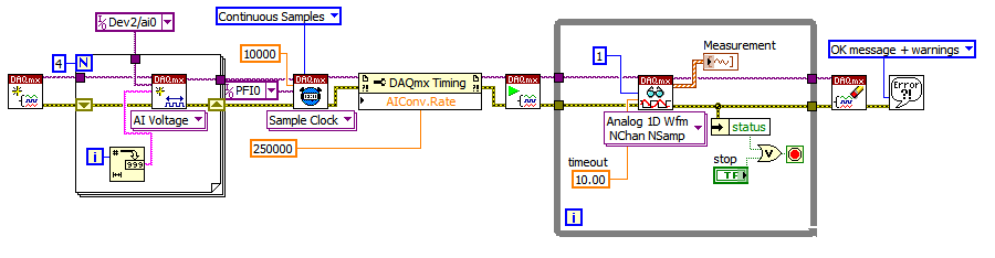

Generally, the best idea is to use a counter to produce 4 sample clocks for AI off of a start trigger from your encoder.  Unfortunately, this takes 2 counters, and you're already using one.  What I would like to suggest, though, is using the pulse from your encoder as your sample clock for AI.  Now, we'll use the fact that this is a multiplexed device to our advantage.  Look at the screenshot I've posted, and I'll try to describe what this is doing.
First, create a task.  Now, add ai0 to the task 4 times with a different name each time.  NOTE: If you want to sample 4 separate channels, you could do this with a single AI Voltage Channel vi and the string "Dev1/ai0:3" or whatever you need.  Now set up the Sample Clock to sample off of PFI0 (your encoder).  Finally, set up your AIConv.Rate to whatever rate you want to sample at every pulse of your encoder.  From then on, reading 1 sample at a time gives you a sample from all 4 of your channels that you care about!

The LabVIEW version you have shouldn't matter with respect to DAQmx Properties.  On the DAQmx Timing Property Node it should be "More > AI Convert > Rate".  The time interval between your 4 samples is now governed by this property, AIConv.Rate.  The rate property on the DAQmx Timing.vi doesn't really mean anything since you're using an external sample clock (PFI0 from your encoder).  If you read multiple samples at a time as a waveform, it would modify the time between samples based upon that rate, but its really a best guess since we can't be certain what you're actually providing.  In the VI I posted, we're only reading 1 sample at a time anyways, so it really means nothing.
Hopefully you can get the AIConv.Rate attribute working, and if so, it looks like this should work for you!

I found the cause of my property node woes, or rather the NI tech support line did - the options become available if I go to Select Filter -> All Attributes in the context menu.
It seems that if I change the number of samples to read from 1 to say -1 or 20 etc, then I get the 2d array of points that I missed since my last call.  This is spot on.
