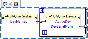

Now, I hope you will forgive me as my text based coding is terrible, but the functions you need are DAQmxGetSysDevNames() and DAQmxGetDevSerialNum().  I'll leave the coding up to you, but the Get Names property will return all devices in your system.  You can then pass these and get the Device Serial Number which will never change.
For any LabVIEW users who come upon this post, here's what your code will look like:
