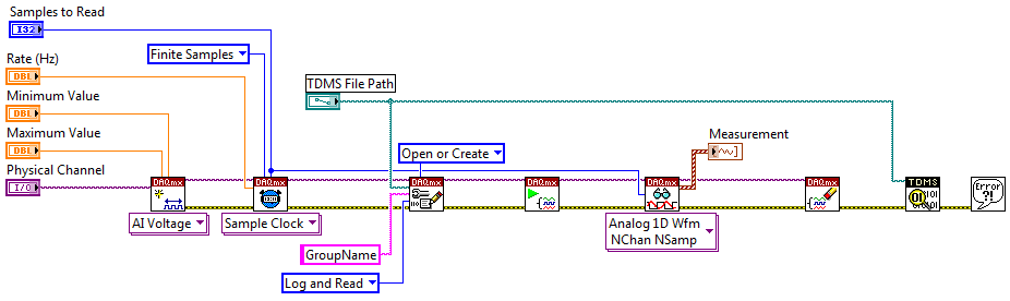

I have Labview version 9.0f3 instored. Measurement & Automation Explorer version 4.60f1 instored.
Do I need to update anything to run the attached VI?
Problem:
As mentioned in the file as follows http://zone.ni.com/devzone/cda/tut/p/id/9574
'NI-DAQmx 9.0 installs a new VI, DAQmx Configure Logging VI'. However I can not find this VI in my control panel and the icon shows as a question mark.
