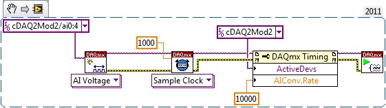

You'll need to specify the module as the active device for the DAQmx Timing Property.  For example:
A cDAQ AI task contains references to both the chassis and the module(s), so even with one module in the task you'll need to specify when setting module-specific properties such as convert rate.
