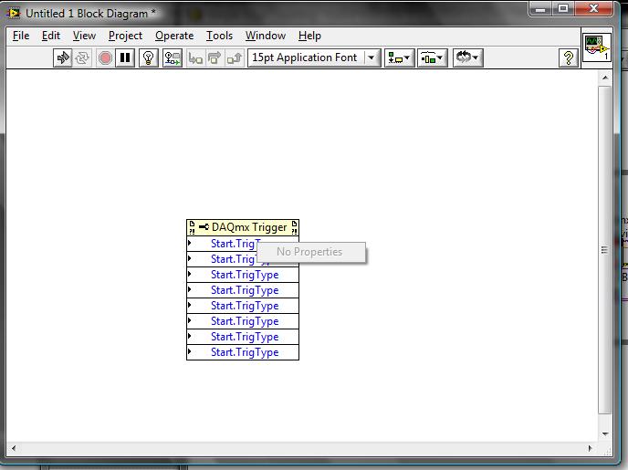

Hi Akshat,
Perhaps the wrong property node was highlighted in the last message.
However, I meant the trigger node while referring to my problem. I followed the steps suggested by you, I could see the property under 'more' but double clicking it wont bring it to use. See this picture (2.jpeg), I have marked the steps with the problem, 1,2,3,4,5

No properties for me:
Message 7 of 8
(6,080 Views)
It seems the trigger property node has filtered out the pause trigger attributes: the property by default filters out attributes that are not supported by the devices in the system.  To get all attribute to show up in the property node, you can right click on the property node and select "Select Filter...".  That should pop up a dialog to allow you to select between "Show Attributes For Configured Devices", "Show All Attributes", and "Show Attributes For Selected Devices".  You can select "Show All Attributes" to show all attributes including attributes that your device might not support, filter it to attributes supported by selected devices by selecting a list of devices in  "Show Attributes For Selected Devices", or show all attributes supported by all the devices currently in your system by selecting "Show Attributes For Configured Devices".
