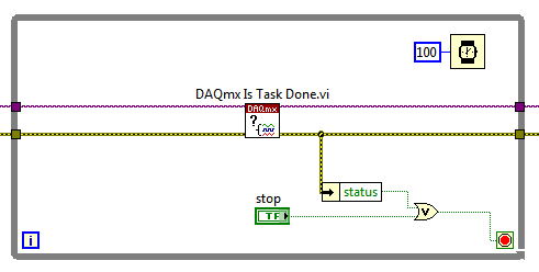

I was able to run the code (although on a different device).  One thing I notice is that you're not breaking out of the loop if your DAQ task reports an error.  I would add something like the following to check for errors during the loop:
