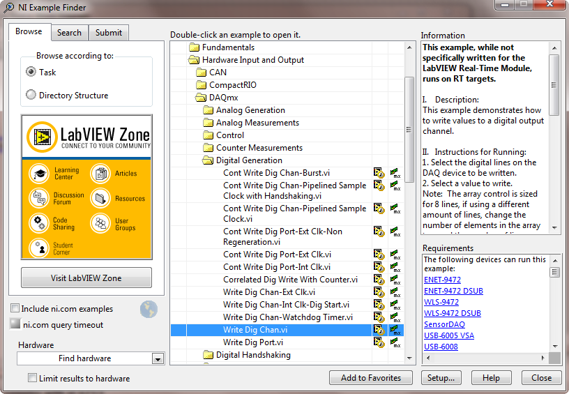

We can then reference the Timing is software timed.  This means that we have to use software to tell the card to output.  With that said, we will not be able to use the DAQmx Timing node before starting the task.  The Timing Node is used to configure hardware timed settings for the DAQmx supported hardware.
A good starting point would be to use a shipping example for Write Digital Channel.  This can be found with LabVIEW open by navigating to Help»Find Examples... and then choosing Hardware Input and Output»DAQmx»Digital Generation»Write Dig Chan.vi
This will allow you to write to your desired line using software timing.
