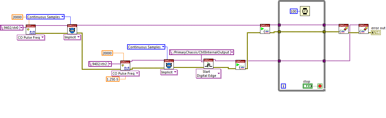

Thanks Katie,
I was able to get it to work by triggering one counter's start from the internal output of the other counter.  This may be more complicated than necessary but it does work.  Notice I still use the "Implicit" timing setting. Once started, the two pulse trains seem to remain in sync.   Haven't tried the Sample Clock method yet.
