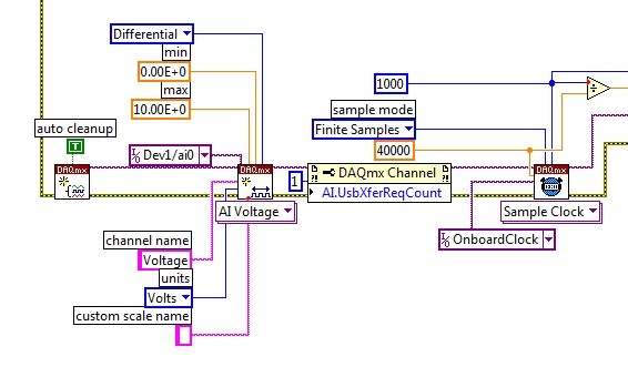

Hi Donald1990,
Below is a screencopy of my code.
A much more detailed instruction will be available at http://digital.ni.com/public.nsf/allkb/611475F9BE62881E86256FDC0062B1BB?OpenDocument
I hope this would be helpful.
Message 26 of 37
(2,781 Views)

Hi Donald,
From what you've posted so far it looks like you're reading from the property, you need to write to it and set the XferReqCount to 1 (you can right-click the property and select "Change All to Write") . You also need to do this before you start the task (in your first image the property was placed after DAQmx Start).
However, BGao's example does do this, so if you're running his example and still get the error then it sounds like your error might not have the same root cause.  Can you post the code you are running and confirm that you are indeed receiving error -200361?  This error indicates an on-board FIFO overflow--the most common cause for this that I have seen is the Windows 7 USB issue (which the workaround in this thread is intended to solve), but if for some other reason the computer is not keeping up with the USB transfers you might also see the same error message.  Are you using an external hub or do you have any other USB devices attached to the same computer?  Which revision of USB is the port on your computer (i.e. is it USB 3.0?).
