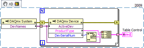

I don't know about 'best practices' for this sort of thing, but here are a couple things that might help you out:
It is possible to list all DAQmx devices through programmatic APIs. For instance, to get all the device types in the system and their names, you could use the DAQmx System: DevNames property to get all devices, and then use the DAQmx Device properties to get information about them. For example:
You could do something like this at startup to figure out what device name corresponds with the device type (like 'PCI-6229' in your example) you want.
