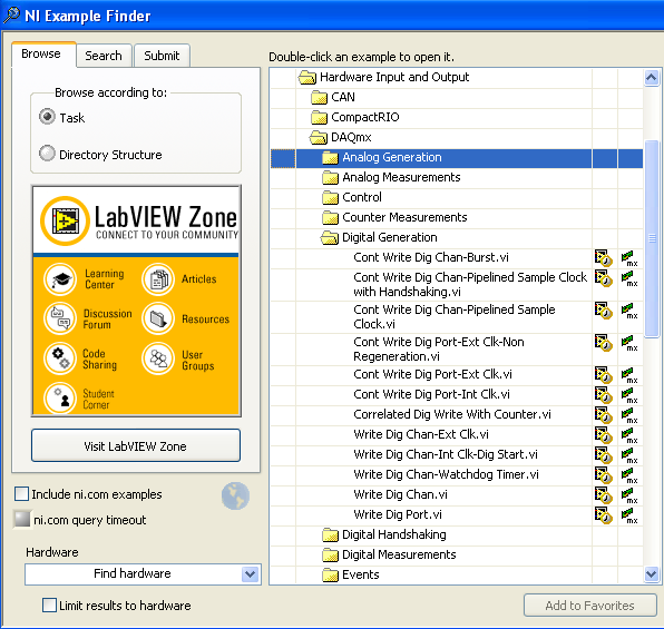

Without explaining, I will ask you have a look at an example Write Dig Chan.vi in the Example Finder. If your question is still now answered, post back.
