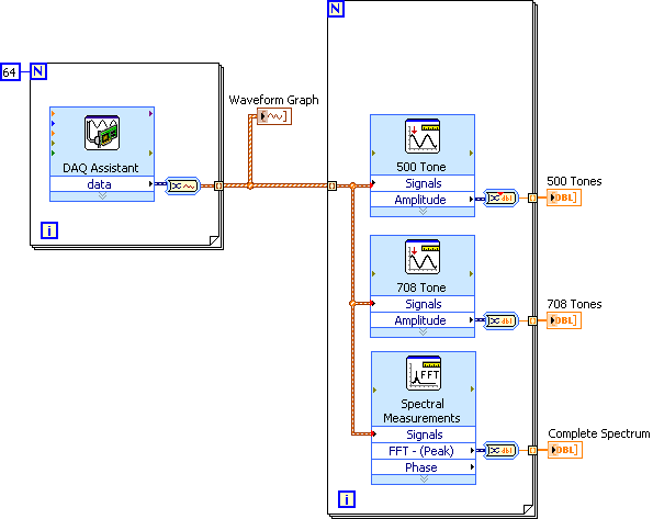

Of course. The example I posted creates an array. Just like the auto-indexing output of a for loop, an array input to a for loop is auto-indexed so that inside the for loop, you work on a single waveform. The code you've written just has to be inside the loop. These sort of things are pretty basic LabVIEW functions and you might want to look at the resources at http://www.ni.com/academic/lv_training/how_learn_lv.htm and http://zone.ni.com/devzone/cda/tut/p/id/5054 for on-line tutorials, books, and classes.

Lastly, I need to take the two tones and save the data.  I have built a simple VI that does what I want to do for each of the 64 sensors but I am not sure how to wisely connect this block with the block that you suggested.  It seems to me that I cannot simply stick this in a for loop and index the data because the FFT blocks need history for only a single channel.  I used the waveform generator to just make a simple simulated input signal.  The Waveform Graph 4 and the complete spectrum are only for debugging purposes in this VI.
So, is there any easy way to replicate this block and operate on the data in the array without simply copy and pasting this block 64 times?  I looked through all of the loop structures but I didn't see any that were really practical for this.

I think you are missing the whole point. Here's a simple example. It has a for loop to get 64 signals. That creates an array of waveforms. Wire that into a for loop with the Tone and Spectral Measurement functions and these will operate on each waveform individually and create an array of results. You put the tone generation function inside the while loop. Fro testing purposes, move it outside in a for loop like I have here with the DAQ Assistant.
Also, what the heck are you trying to do with the tick count and merging that with the dynamic data? When you get dynamic or waveform data from DAQ, the data type includes timestamp information.
Oops. I jsut noticed that I didn't change the From Dynamic Data for the Spectral Measurement to create a waveform instead of the scalar.
