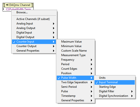

The 6251 only has 2 counters so you can't measure more than two channels at a time.  However, you may sequentially measure the different channels on the two available counters.  Any of the PFI lines on your 6251 should be able to be routed to the counters with a DAQmx Channel Property node:
The other APIs have similar properties that you can set to change the input terminal.

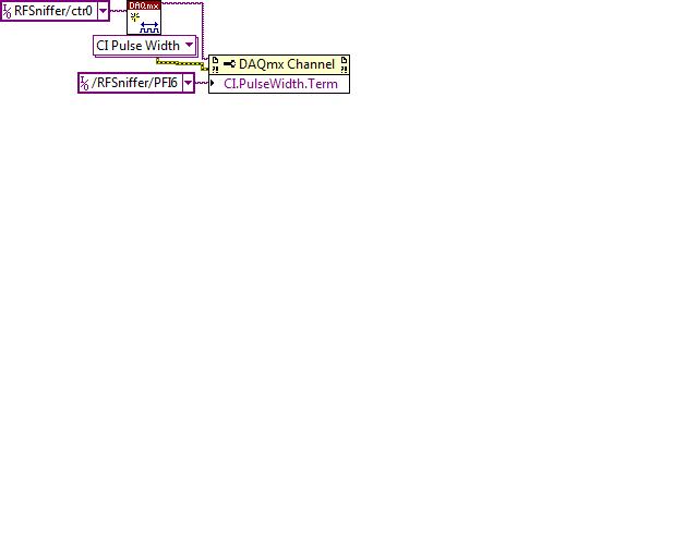

Thank you John. I was playing with that option. Have one more question. Where do you put channel property, after Virtual channel.v?
Is the picture has corect order ?
Thank you

After the create virtual channel should be fine.
Also, if you want to change the input without restarting the entire program you can stop the task, call the channel property to change the channel, and restart the task.
The change detection is also a good idea, but it does get a bit complicated to efficiently program all of the logic required to compute the measurements in software.  I've played around with the idea before but ran into some problems if the pulses came too close to one another on the respective lines.
