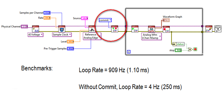

  • Commit—If your application performs multiple measurements or generations by repeatedly starting and stopping a task, explicitly commit a task. Committing the task exclusively acquires the resources that the task uses and programs some of the settings for these resources. By explicitly committing the task, these operations are performed once, not each time the task is started, which can considerably decrease the time needed to start your task. For example, if your application repeatedly performs finite, hardware-timed measurements, the time required to start the task can dramatically decrease if you explicitly commit the task before repeatedly performing these measurements. Explicitly committing a task also is required if you need to perform additional read operations of the samples acquired by the task after stopping the task. For more information, refer to Using the Start Task Function/VI
For confirmation of the behavior, here's a benchmark that I put together for some training slides.  The benchmark was taken on a PCIe-6353, sampling 4 samples per trigger @ 1 MHz.  The input trigger signal was a 100 kHz sine wave.
With the high sampling rate, low amount of data, and fast trigger signal, the observed loop rates are almost completely due to overhead from the task-state transitions.  I chose to use a reference trigger since start triggers are now re-triggerable in hardware for X Series.
The suggestion to make the task state queryable would be a good one for the idea exchange.  Does somebody want to post it there?

I see how the diagram from the DAQmx Help does give off the impression that calling DAQmx Stop will always revert back to the "Committed" state.  However, this is not the case.
DAQmx Stop will revert back to the state that the task was in before it was last started.  The diagram should probably indicate this somehow, but I'm not sure the best way that NI could illustrate the behavior without killing the readability of the diagram.  Although, I suppose that a messy-but-accurate diagram is probably better than an organized-but-incorrect one.  The description of the actual behavior can be found in the Explicit Versus Implicit State Transitions section of the help:
@for confirmation of the behavior, here's a benchmark that I put together for some training slides.  The benchmark was taken on a PCIe-6353, sampling 4 samples per trigger @ 1 MHz.  The input trigger signal was a 100 kHz sine wave.
