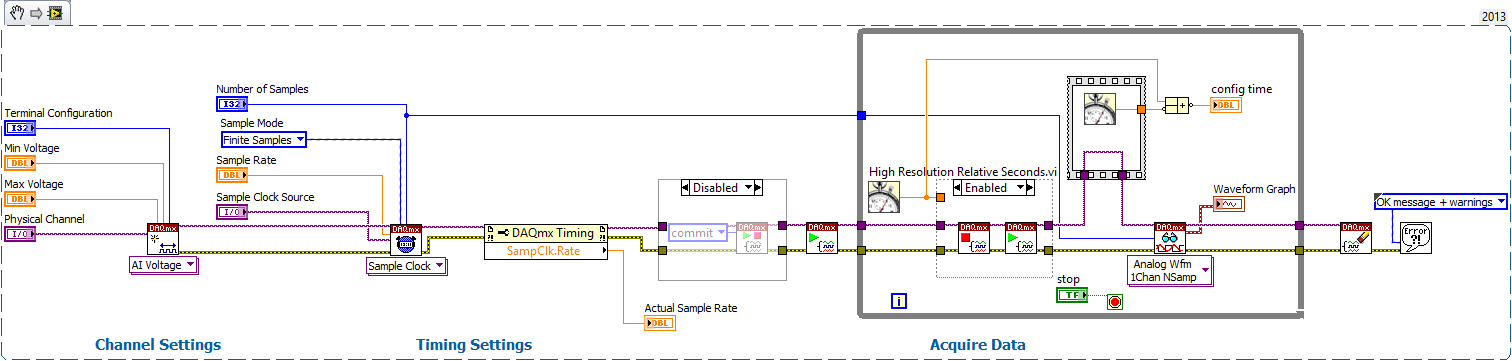

Here is the vi I am using for tesing the concept. It is a modified version of the example for finite input.
Without using control task and commit - Loop - 215-220ms
With control task and commit - Loop - 170-175ms
Additional Info:
The funny thing is there is a difference between simulated HW and actual HW. The above timing holds when I have my sensors connect to the AI module
When I use simulated HW, these are the times.
Without using control task and commit - Loop - 145-150ms
With control task and commit - Loop - 105-110ms    (This time would ideal for my application but I don't know why there is an additional 70ms)

Thanks, but I'm still running LV 2013 and can't open the vi you posted.  Can you save back to 2013 or post a screenshot?

You should be able to open this in LV2013 now.

At 10 kHz sampling, reading 1000 samples at a time, I regularly get loop times of 101-103 msec.
Using the "commit" first seemed to give me more 101's while skipping it seemed to give more 103's, but there really wasn't a lot of difference.
I tried both a PCI M-series card and a PCIe X-series card.  I put some sequencing in your loop to make sure the tick count query happens at the end of the loop.  I tried both finite and continuous sampling.   None of those changes mattered in an obvious way.  There were only a few extra msec consumed by doing a stop and restart.  Never anything close to the 75 or 100 msec that you described.
Wondering if you're using a USB or cDAQ board b/c my PCI and PCIe multifunction boards both support much lower overhead looping.  Attached is a modified version that measures only the stop/restart time with a higher resolution clock.   I kept seeing about 1.1 msec with the commit, 1.5 msec without.
-Kevin P

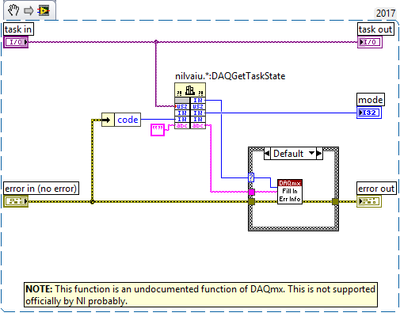

Disclaimer: I know this is an old post, I just don't know if I should create a new one and reference this one, since I believe this technically answers the post's question and I wanted to share my solution. (Please advice)
I actually had this question myself a while ago. I was also pretty curious as to why there was a way to set states through the API but no explicit get method for it.
Like OP mentioned, there's actually a function in the nilvaiu.dll called:
int32_t DAQGetTaskState();
Which is pretty self explanatory, the only issue being that the function parameters/signature is unknown and since it is undocumented, they didn't know how to use it.
A bit of background: I was taking a look at the C API of DAQmx and looked at other function calls in the LabVIEW DAQmx API and just tried setting something that would probably look like it/match existing usage of other functions. (At least according to me)
This is what ended up working for me:
int32_t DAQGetTaskState(uintptr_t taskID, int32_t *mode, int32_t incomingStatus, LStrHandle extendedErrorInfo);
I just changed mode to a pointer for reading like in other calls/similar functions. (Pretty much just a guess/luck)
I'm sharing the SubVI here:
A few notes/info:
  • I've tested the VI and it works. I've managed to query the state of the tasks I've run. However, I've only tested this in a single cDAQ chassis (9178) and a digital output module (9472). There's no guarantee it would work in other systems, which brings me to the next note.
  • This is an undocumented function of DAQmx. So there's obviously no official support as far as I can guess, so I probably would not rely on it. I'm using it for educational purposes.
  • The mode ring output includes 2 other values that appear in the C API in "DAQmxTaskControl", so not just the 5 states in the action input of DAQmx Control Task.vi
(I'm assuming this really is undocumented so if it turns out it actually is documented and I didn't find it, then I goofed. I'm still a noob overall)

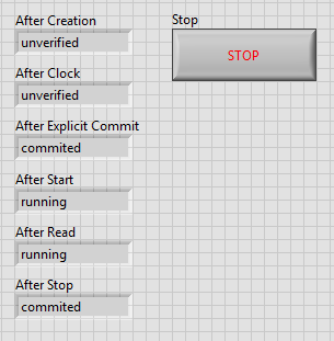

Ok. So somehow I goofed in a really dumb way.
So I tested with more hardware and realized that the constants I'm using are wrong since those are for setting the states. There is no state such as un-reserved. The actual states as described in the documentation are the following:
  • Unverified
  • Verified
  • Reserved
  • Commited
  • Running
I've tested again and NOW I'm seeing consistent behavior. (I still wouldn't rely on it though since its undocumented)
I'm editing the SubVIs above.
I've also attached a small example/test for reference below:
This were my results:
Edit: Ok. So I guess I can't edit the previous post. I've attached the correct one here:
Edit 2: This is embarrassing. Updated documentation.
