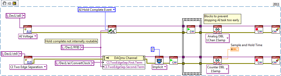

There is a sample and hold circuit on the device.  The convert clock marks the beginning of the sample interval while the AI hold complete signal marks the end.
I'm not sure if the hold time is specified anywhere, but you should be able to measure it like this (LabVIEW example... I don't have MATLAB or the Data Acquisition Toolbox unfortunately):
On my PCIe-6351 I get a hold time between 440 and 450 ns.  The 6220 might be different but hopefully this gives you an estimate.  This parameter is not adjustable.
Having said all of that I don't think it is relevant to your issue.  If your input signal is varying between discrete levels and you want to sample only after it has settled to a new value, you'll need to ensure that the AI task is synchronized to whatever is generating the signal.
