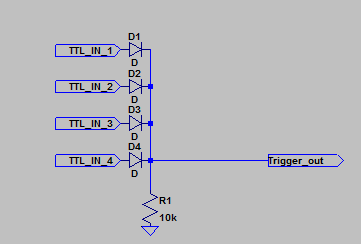

Depending on your signal sources and the slope.... I would make a wired OR with some diodes (1N4148) and a pull down resistor, just like John proposed.
